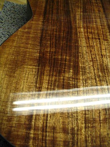

I'll try to get some pics up soonish (maybe tonite), I promised Hesh some so he could see the tiger myrtle bindings under finish and I've been too busy building other stuff and wet sanding/buffing out the finish on this guitar. Seems I lost some of my spray painting skills in the twenty years since I did it for a job. .
One thing I noticed was that I did get some witness lines while wet sanding. Made for a sleepless night. Can't see them once that area is buffed tho, even under different light sources. In future I'll not let the first coat dry completly before laying down more.
You'll like this stuff Kim, best finish I've done in a long time.

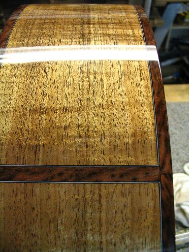

Ok, here are a couple of pics. This guitar is Taz blackwood with taz tiger myrtle bindings. Incidentaly this set of blackwood only cost me about $AUS42. Dunno what that is in US dollars, but it ain't much , less than taking the family to macdonalds. Just right for guitar #2.
Appologies to my friend the Heshmiester. I promised him some pics of Taz tiger myrtle under finish, and I've been way too busy to take any. Sorry buddy that I didn't come through for you .
When I said that I'd buffed the finish, I really meant that I'd polished it with Novus plastic polish #2 (kinda like like a car polish without the silicone) that's it, wet sanded to 2000 grit then polished by hand. A buffer would give an awesome result.
Kim, another good thing about this stuff is that Neil the guy who makes it is a great bloke and is totally happy to talk to you about it. Lots of hints and tips (like they no longer recommend that you use another shellac for the first coat). He also owns the ubeaut woodwork forums, which is one of the great woodwork forums. We even see our mate Serge there
Heshtone, These bindings were about as dark as the darkest part of your back, and the colour looks about right at least on my monitor. So that's about what you can expect. It looses the redish cast and becomes more chocolate under shellac. Still nice though.PaulB39037.1921296296

               That looks awesome Paul !
What a fantastic combo ! I'm really looking forward to seeing the complete guitar .
A great looking finish.

Paul that is one superb look'in finish, absolutely first class, and from what I can see, your no slouch in the binding department either. Well done mate.
The blackwood looks delicious and the tiger seems right at home, so much so that I know i will not be the only one baying for MORE IMAGES PLEASE .
As for Ubeaut's Hard Shellac, I am sold, this is a done deal. I will be contacting Niel in the near future so thanks very much for taking the time to post this mate. I have been going to go this way and then that but this product, having a unique cross linked shellac, seems to offer the very best of both worlds.
My only reservation remaining its use on the top. If this product is as tough as a poly, what would be the affect on the top tonally? I imagine that a rubbed FP application would be thin enough to have little or no affect, but have you done your own top with this product and if so what affect do you think it had?

Thanks guys, Kiwi has been a collaborator with this one giving me lots of good advice, and I know he's been waiting to see it for a couple months now. I've been holding off on the pics so I can do "The Great #2 Unveiling". But other people need to see some aspects of it, and I don't like to hold back info for my own selfish reasons when I owe so much.
The great thing about this stuff, at least in spraying it (and I only gave it two coats, neat straight out of the bottle 'cause the viscosity seemed about right) is that after rubbing back, the thickness is comparable to a FP finish thickness (yes I had to repair a scratch so I got to find out how thick it was which is bugger all) This guitar sounds awesome. I had it strung up and was playing it for about six weeks while I waited for the hard shellac to fully cure. It sounded a bit bit muddy for the first couple weeks. Hence my question to Al the other day about the dampening factor of guitar finishes, 'cause thats what I seemed to be hearing. Now it sounds great and I can't wait to put it back together and start playing again. And yes I did spray the top, same as everything else.
